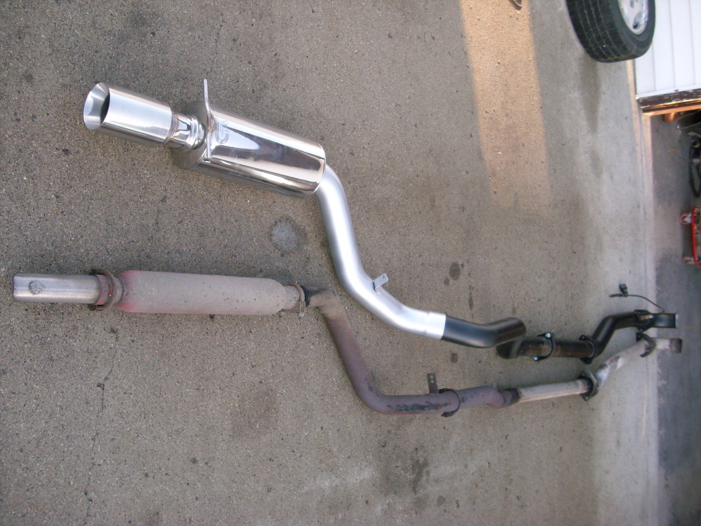

<p dir="auto">Exhaust<br />
Ported stock exhaust manifolds<br />
Ported stock turbo turbine housing (T3)<br />
Ported internal wastegate<br />
Ported turbo exhaust outlet elbow<br />
Certified Muffler 3 inch exhaust (cat delete with Magnaflow muffler)</p>
