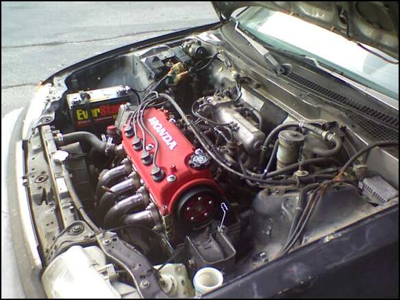

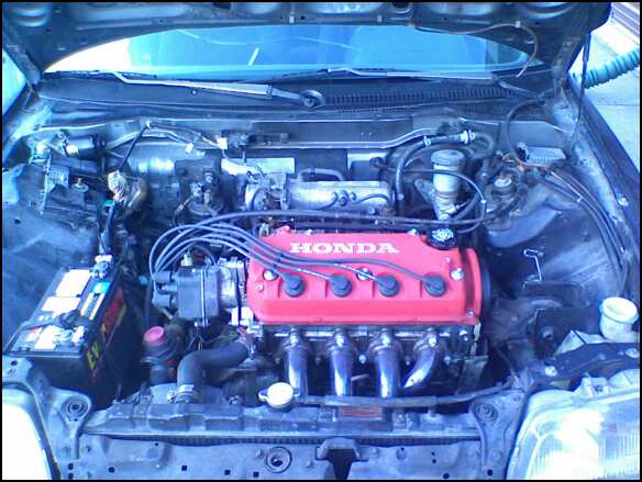

<p dir="auto">Engine:</p>
<p dir="auto">d16a6 block, d16y8 head swap, y8 head gasket, y8 timing belt.</p>
<p dir="auto">11.1:1 Cr</p>
<p dir="auto">d16a6 throttle body, intake manifold, injectors</p>
<p dir="auto">d16y8 distributor</p>
<p dir="auto">short ram intake (not in pic)</p>
<p dir="auto">ebay 4-2-1 header</p>
<p dir="auto">frankensteined ebay exahaust (originally for CRX)</p>
<p dir="auto">OBX adjustable cam gear.</p>
<p dir="auto">Short throw shifter kit w/ mad tyte shift knob yo.</p>
<p dir="auto">Electric stuff:</p>
<p dir="auto">MPFI conversion</p>
<p dir="auto">OBD1 conversion w/ DIY conversion harness</p>
<p dir="auto">Added vtec wiring, 4 wire o2, etc.</p>
<p dir="auto">converted and chipped p28 spec ecu w/ datalogging, ostrich<br />
RTP</p>
<p dir="auto">I think thats about it.  All work was done by me, with no help except for the peeps on <a href="http://d-series.org" rel="nofollow ugc">d-series.org</a>, pgmfi, and honda-tech.  All the wiring is soldered, loomed.</p>
<p dir="auto">I'm using crome to tune and running a p30 basemap w/ p2p fuel map, running super rich.  The timing is alllll fucked up, due to several factors including deck height, y9 cam gear offset, weird ass p2p ignition timing.  I got it close and the car runs fine but doesn't make the power I think it has the potential to make, and won't until I get it on a dyno.</p>
<p dir="auto">I've put basically all my time into the motor, so the car still needs shocks, brakes, tires, paintjob etc.  I've got a bunch of other stuff sitting here like a crower stage 2 cam, dsm injectors, bigger fuel pump, and a disc brake conversion which I need bigger wheels for.  I'll get that stuff done whenever time permits.</p>
<p dir="auto">This build has been a real pantload.  I learned soooo much though doing it myself.  I've gained alot of confidence in my wrenching abilities.</p>
<p dir="auto">I'm jonesed to get it on a dyno and get the timing and fuel maps right but that might not happen until next spring, I don't know.  As it's tuned now, it's not even quick, i've never revved it out, never raced anyone, and I won't either, so I have no idea how quick it will be at this point.</p>
<p dir="auto">Any questions, comments?</p>
