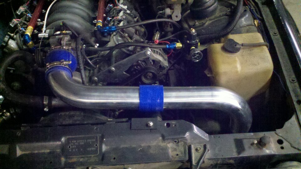

                                    Ok here is an update with some picture's. Transmisson is a th-350 with a b&m stall

                                      well it's been a while since an update. computer wiring done under the hood and radiator ordered and modifed

                                        Well it's almost done. just waiting on b.o.v. got it running last week.
                                        [legacy attachment 6929]

                                          Got my b.o.v. today. But i was able to drive it before i got home and saw that it showed up. Car run's really good considering it's not tuned at all. I also have traction issue's as soon as it start's to boost the tire's break loose.
