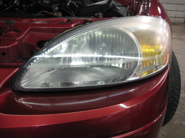

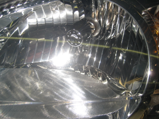

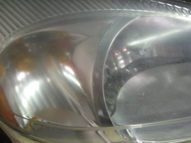

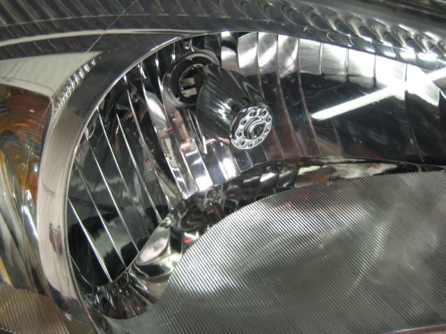

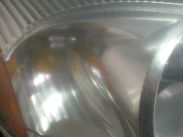

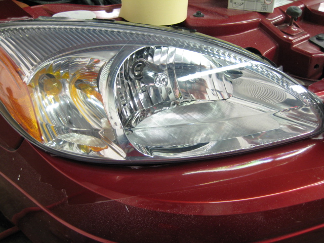

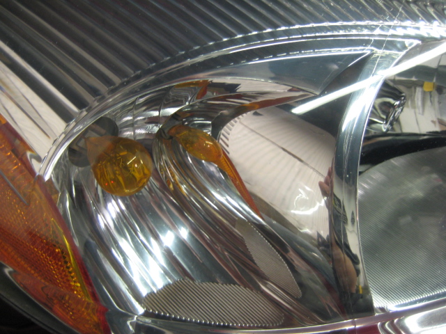

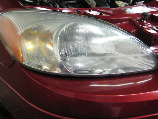

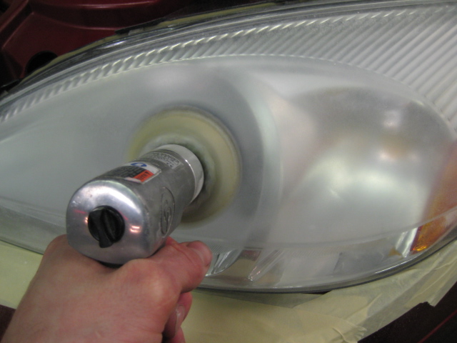

    aliengotpsi
    2000 Ford Taurus 92,125 Miles
    Dealer Car
    Kevin Smith
    Straightlinedetailing.com

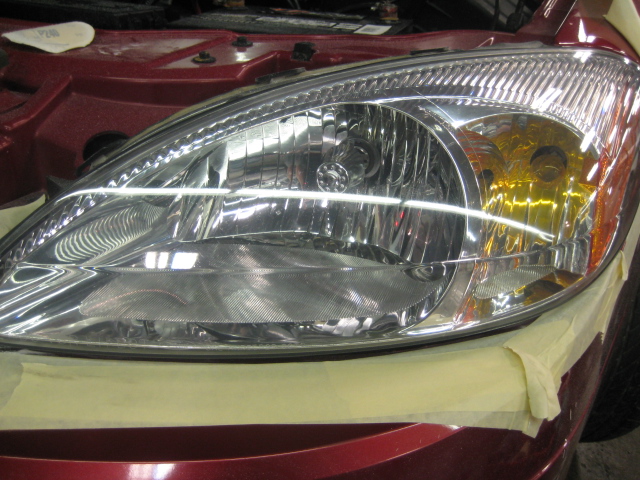

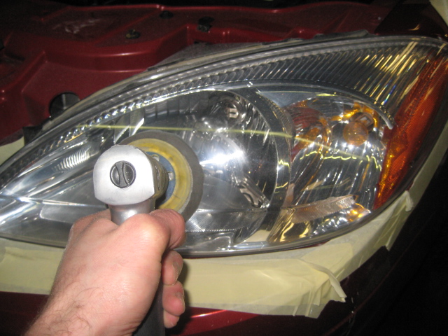

      aliengotpsi
      Passenger Side
      Kevin Smith
      • DrifterExtremeD Offline
        DrifterExtreme
        Wow great job. how much you charge for this?
          good plan switching to air powered tools kevin :thumbs up:
            aliengotpsi
            Yeah we have switched over to air after doing up to 40 sets a month..
            We usually charge $50.00 (dealer price) We don't advertise it so we don't get many retail clients wanting this.
            $60.00 retail
            That set was not very bad but you get the idea..

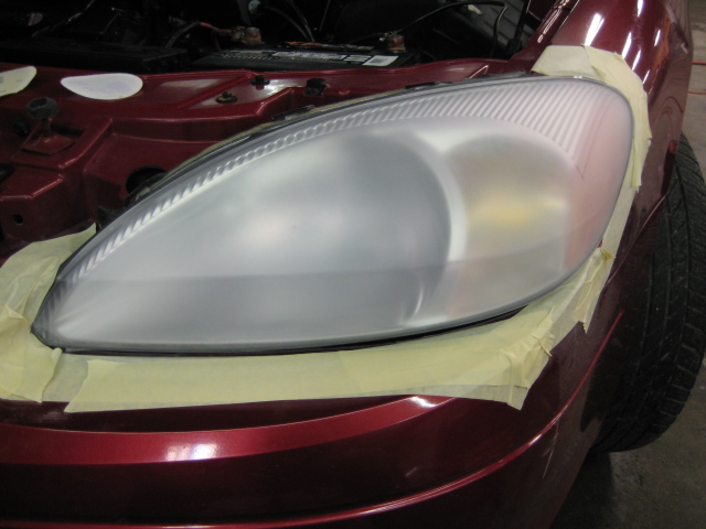

                    Wes its, sand paper, Air DA sander, Dewalt buffer, mini polisher, UV clear coat..

                        aliengotpsi
                        Most cars get sanded W/
                        240
                        400
                        600
                        1000
                        1500
                        Then buffed
                        Cleared w/ uv clear
