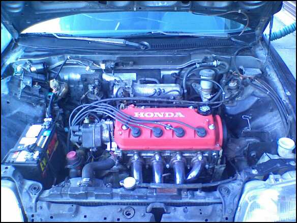

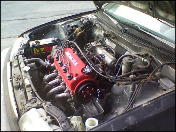

My DD, ongoing project.
Here's my little hatch. Used to be svxAL's IIRC.
Engine:
d16a6 block, d16y8 head swap, y8 head gasket, y8 timing belt.
11.1:1 Cr
d16a6 throttle body, intake manifold, injectors
d16y8 distributor
short ram intake (not in pic)
ebay 4-2-1 header
frankensteined ebay exahaust (originally for CRX)
OBX adjustable cam gear.
Short throw shifter kit w/ mad tyte shift knob yo.
Electric stuff:
MPFI conversion
OBD1 conversion w/ DIY conversion harness
Added vtec wiring, 4 wire o2, etc.
converted and chipped p28 spec ecu w/ datalogging, ostrich
RTPI think thats about it. All work was done by me, with no help except for the peeps on d-series.org, pgmfi, and honda-tech. All the wiring is soldered, loomed.
I'm using crome to tune and running a p30 basemap w/ p2p fuel map, running super rich. The timing is alllll fucked up, due to several factors including deck height, y9 cam gear offset, weird ass p2p ignition timing. I got it close and the car runs fine but doesn't make the power I think it has the potential to make, and won't until I get it on a dyno.
I've put basically all my time into the motor, so the car still needs shocks, brakes, tires, paintjob etc. I've got a bunch of other stuff sitting here like a crower stage 2 cam, dsm injectors, bigger fuel pump, and a disc brake conversion which I need bigger wheels for. I'll get that stuff done whenever time permits.
This build has been a real pantload. I learned soooo much though doing it myself. I've gained alot of confidence in my wrenching abilities.
I'm jonesed to get it on a dyno and get the timing and fuel maps right but that might not happen until next spring, I don't know. As it's tuned now, it's not even quick, i've never revved it out, never raced anyone, and I won't either, so I have no idea how quick it will be at this point.
Any questions, comments?

i dig it, ive always like this car. pics of the whole vehicle?
SPANISH-RICE;288616 wrote:
i dig it, ive always like this car. pics of the whole vehicle?Looks the same, except cracked primer on the front quarters, a rust spot on the drivers side rear quarter, center console torn up from some fucking jackass who really wanted my deck and thought tearing the heater controls out was a good way to get it. i'll try and take pics tomorrow tho.
